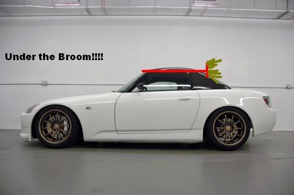

As I interpret the rules, as long as your helmet is below a broomstick placed level on the windshield header, you should be o.k. Maybe others will chime in and further clarify the rule.

PLEASE NOTE THAT I AM NOT AN OFFICIAL SOURCE OR AUTHORITY ON THIS RULE.

I think this rule was in effect at the March meet and all of the S2ks pretty much met the standard. Best to, as was suggested, take a picture and contact Rick to be sure.
